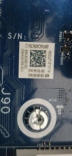

It's a desktop. I took a pic of the board model. Is that what you need?Hello, can you please send the motherboard model of that laptop?
This isn't the model.It's a desktop. I took a pic of the board model. Is that what you need?
I'm not seeing anything else useful?This isn't the model.
All these models are the same, and from the same batch.
This is what I'm coming up with.
Serial Number : MXL1391CDF
Product Number : 2X3N0UT
Description : HP Z2 G5 TWR i7-10700K 16GB/512 PC
