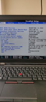

I have 60 of these lenovo p50 laptops I need to get into. is it possible to get a bios to load into the chip that will work for all of them. they are identical.

loaded and verified. three green blinks when i hit the power button and it does not boot with the file you gave me

you need to program EC file to remove password

maybe im not explaining it correctly. i have a ch431a programmer with soi8c clip. how do i unlock the bios of these computers

"Instructions for use"
Remove all battery and CMOS battery
press F1 to enter setup: password 1234
wait 20sec or more.
Enter any ID to hardware Id.
Press 2x space bar when asked.
Turn off the computer.
and restore your original bios .
Enjoy.
If 2x 5beep, it's normal.
I didn't do checksum but it must light up anyway.
Wait minimum 30sec before screen logo light on. Must turn on/off several times by itself :
