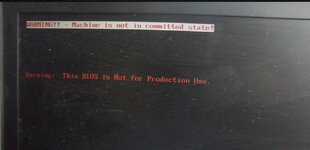

Article How to solve' Warning!! - machine is not in committed state!
Vahab Hemmati
Support Team
Staff member
Admin
How to fix this problem ?
There are 3 Brands for solve this problem : Brand11 - Brand12 - Brand13
Brand11:
1. Copy folder Brand11 to the root of the USB key formatted as FAT32.
Your USB key should have less than 40 folders and files in the root.
2. Goes to F10 -> System Configuration -> Boot options -> UEFI Boot Mode
-> Press "Enter" to enable EFI boot -> Select "Accept" -> Save and exit.
3. Press F9 then "Boot from EFI File", then select your USB key -> Brand11
-> Bootx64.efi -> Press enter to run startup.nsh
4. Follow menu to commit AMT and AT.
Chose 1 to commit VPRO with AT, or 3 to commit Non-VPRO with AT
5. Press 9 and then Enter key to lock descriptor and reboot the machine.
6. Press F9 then "Boot from EFI File", then select your USB key -> Brand11
-> Bootx64.efi. You should see the message "Pass!!! This machine is configured"
7. Reboot to F10 and disable EFI boot mode.
Brand12:
1. Copy folder Brand12 to the root of the USB key formatted as FAT16/FAT32.
2. Goes to F10 -> System Configuration -> Boot options -> UEFI Boot Mode -> Press "Enter" to enable EFI boot -> Select "Accept" -> Save and exit.
3. Press F9 then ìBoot from EFI Fileî, then select your USB key -> Brand12 -> Bootx64.efi.
Brand13:
1. Copy folder Brand13 to the root of the USB key formatted as FAT16/FAT32.
2. Goes to F10 -> System Configuration -> Boot options -> Boot Mode -> Choose "UEFI Hybrid" mode -> Save and exit.
3. Press F9 then ìBoot from EFI Fileî, then select your USB key -> Brand13 -> Bootx64.efi.
ENJOY !
